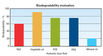

Figure 1. Biodegradability of various base fluids after 28 days according to OECD 301B shows that many synthetic base stocks are readily biodegradable.

Fluids used in these applications need to pass biodegradation testing and, in some cases, aquatic toxicity testing. These fluids are manufactured using some type of synthetic base stock, such as polyalkylene glycols (PAG), polyol esters (POE) or diesters, or some grades of polyalphaolefins (PAO). Mineral or petroleum based oils are not biodegradable, but oils based on plant seeds, such as rapeseeds or soybeans, are biodegradable.
Figure 3. Test results according to ASTM method D 2070 show that vegetable and mineral based fluids exhibit substantially greater sludge formation after 96 hr at 275° F.
But not all biodegradable hydraulic fluids are the same — biodegradability does not necessarily mean not harmful to plants or vegetation. Only polyalkylene glycol based hydraulic fluids (used as recommended by equipment manufacturers) have demonstrated minimal or no harm to plants or vegetation, which is critical in sensitive applications.
As shown in Figure 1, many synthetic base stock chemistries have excellent biodegradation. They also have low aquatic toxicity, as measured by OECD 203. However, some do not meet the high performance standards that may be required of hydraulic fluid.
