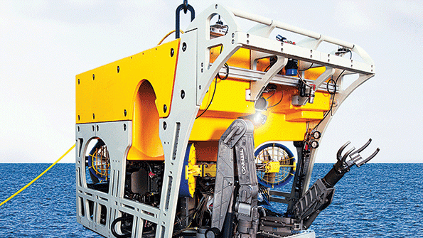

Designed to operate in extremes of pressure and temperature, this remotely operated vehicle (ROV) can work at depths of 4,000 m (13,000 ft) and ambient pressures to 21 MPa (3,000 psi). It performs multiple tasks, including enaging and disengaging hydraulic lines using hot-stab connectors. (Courtesy of FMC Technologies-Schilling Robotics)
An ROV will remove the plug stab and set it into a designated place holder, then place the live hot stab into the female receptacle. Once the connection is sealed, fluid from the topside will run through an umbilical, through the live hot stab, and into the subsea equipment being activated. The configuration of the hot stab can vary greatly depending on its application, namely the porting, material composition, flow paths, and special testing requirements.

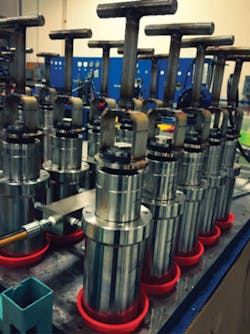

This batch of hot-stab connectors undergoes pressure, leak, and other testing prior to shipment.
Once a raw material passes ultrasonic testing, it is sent back to the hot-stab manufacturer for machining before being shipped out for dye-penetrant inspection. During dye-penetrant inspection, sub-components are coated with a fluorescent dye. Capillary action then draws the dye into any imperfection. After a specified time period, excess dye is removed and a developing agent is applied. Technicians inspect each part for defects, ensuring that the machining process did not damage the integrity of the hot-stab materials. If a small line or other flaw is revealed by the penetrant dye, it could indicate a crack developed during a machining process, and may be cause for material rejection.
NDT procedures are a bit different, and include proof testing and hardness checks. Proof testing, or pressure testing, is usually conducted by applying hydraulic pressure to the hot stab’s ports and taking them either up to the designed working pressure or beyond for a predetermined amount of time, depending on test requirements. Hardness checks are also critical for subsea equipment, because materials with a higher hardness may be more susceptible to cracking.
