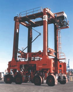

Much of the yard equipment at the Port of Tacoma is owned and operated by the port authority or leased to private stevedores. Each machine operates for 200 to 2,500 hr annually. In an attempt to reduce maintenance and extend the life of its container handling straddle carriers, Figure 1, authority officials first experimented with hydraulic fluid testing in 1994.
Initially, a testing system was tried with the hydraulic fluid on two older Drott hydrostatic straddle carriers and two Kalmar lift trucks. The straddle carriers are huge machines: the tires in the machine pictured are more than 6-ft in diameter. These carriers operate at pressures to 4,000 psi and have two 75-gal reservoirs supplying Dynapower piston pumps, manufactured by Eaton Hydraulics. The lift trucks have a lower operating pressure of 2,900 psi and 80-gal tanks fitted with Vickers piston pumps. The oil used is Chevron AW MV ISO 46 hydraulic fluid.

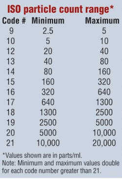

The first step was to assess the contamination of the hydraulic fluid by particle counting, which detects the size and quantity of contaminants in the fluid. The framework is provided by ISO 4406, which gives two measures: the total number per ml of particles 5-µm and greater in size and 15-µm or greater. This is expressed as two numbers, for example 17/15, each of which denotes a range of the actual number of particles (see Table 1, below).

Summary of particle codes according to ISO 4406.

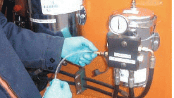

Preliminary tests are now carried out on site. A sample of hydraulic fluid is taken from a gauge tap adapter that is installed just before the return filter, Figure 2. The fluid sample flows through a microbore hose with swivel fitting. With oil at operating temperature, a 4-oz bottle is filled and examined by a technician, who has a small lab set up on-site. The oil is diluted with hexene and pulled by vacuum through a patch, which the technician subsequently views through a microscope. If anything out of the ordinary is observed, a second sample is taken and sent off for an accurate particle count and viscosity check.
