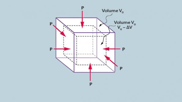

Figure 1. Fluid volume decreases with increasing pressure. The secant bulk modulus is also called the "average" modulus, and the tangent bulk modulus is also called the true modulus.Click on image for larger view.
Most substances diminish in volume when exposed to a uniform, externally applied pressure. A typical plot of volume vs. pressure is shown in Figure 1. The curve shows that:
V = f (P,V0, k)
where: k = compressibility (usually negative), in.2/lb
P = pressure, psi
V0 = initial volume, in.3
The term bulk modulus usually means the reciprocal of compressibility and defines the slope of the curve in Figure 1. A steep slope signifies a stiff, only slightly compressible fluid — one with a high bulk modulus. A flat slope signifies a fairly compressible fluid — one with a low bulk modulus.
