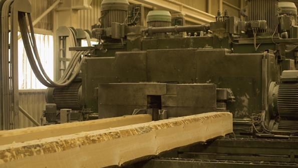

Saw mills operate multiple pieces of large equipment with hydraulic systems. When this equipment faces unplanned downtime due to important components becoming fouled from contaminated fluid, profits decrease while production costs increase. This causes a huge financial burden that can feel exponential as components must be repaired or replaced.
When all factors such as maintenance personnel hours, replacement parts, fluid consumed, and decrease in profitability are considered, it is easy to understand the substantial cost impact that occurs due to fluid that is poorly cared for. Identifying fluid contamination issues provides an excellent opportunity to lower operating costs and increase efficiency.
Applying a total systems cleanliness approach is necessary to maximize uptime, extend component life, extend fluid life, reduce maintenance resource demands, and reduce fluid disposal costs. For example, upgrading from cellulose to fiberglass filter elements, installing desiccant breathers, and installing off-line filtration can be quite effective in improving hydraulic fluid cleanliness.
