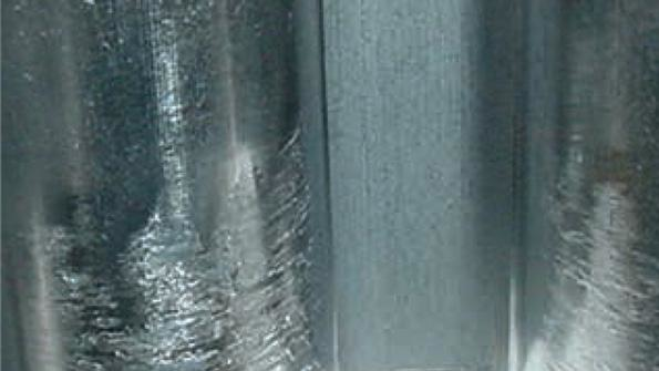

1. This scoring resulted from using a fluid with too low a viscosity for the load. The damage was caused by metal-to-metal contact of mating components. Click on image for larger view.

Low-viscosity fluids provide thin film thickness, leading to boundary lubrication conditions, which can result in metal-to-metal contact and damage system components. For example, when two moving metal surfaces contact each other with inadequate lubrication, excessive wear can occur due to cold welding (Fig. 1), and damage components. Low viscosity also reduces volumetric efficiency of pumps and motors through increased internal leakages.
