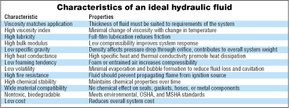

Matching the Fluid to the Application
Gone are the days when selecting a hydraulic fluid meant simply finding one with performance characteristics that matched the application. Now you have to determine whether fire resistance and environmental compatibility must be thrown into the mix. And if so, how much weight will they carry relative to performance and price. Fortunately, manufacturers have responded by developing a wide variety of products to serve an even wider diversity of applications. The challenge now becomes choosing which particular fluid is best suited to a particular application.
