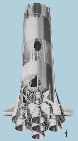

The S-IC stage of the Saturn V launch vehicle will be propelled by five F-1 engines  generating a total thrust of about 7.5 million pounds. This compares with the eight H-1 engines of the S-1 stage of the Saturn I vehicle, generating a total thrust of 1.5 million pounds.
Booster for the Saturn V is this S-IC stage. It has five F-1 engines, each producing about 1.5 million pounds of thrust. The four outer engines are gimballed. The center one is fixed.

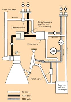

Preliminary design calculations indicated that considerable beefing-up of gimbal systems of the type used for the Jupiter and Saturn I vehicles would be necessary to meet the greatly increased requirements of the S-IC. Thus, it became appropriate to consider whether it would be more advantageous to design an altogether new system employing the latest concepts in hydraulic actuation.

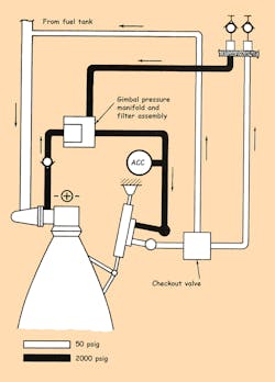

The final choice was between a high-pressure, closed-loop, conventional hydraulic system utilizing MIL-H-5606 and a fueldraulic system in which RP-1 (kerosene) fuel, taken from the high-pressure side of the turbopump, is used as the fluid medium in a single-pass system. Flow from the actuator returns to the fuel system, rather than to a hydraulic reservoir. The figure permits a comparison of the essential features of the two systems. Because each became a matter of considerable controversy, with different groups favoring whichever system most nearly fulfilled their specific requirements.
Conventional System vs. Fueldraulic
A major factor favoring selection of a beefed-up conventional hydraulic system was the extensive experience gained from previous vehicles. However, increasing the operating pressure and flow rate for such a system from 3,000 to 4,000 psi and from approximately 15 to 100 gpm, respectively, to meet S-IC requirements would necessitate redesign and qualification of most major components. Therefore, it was argued that these changes would exceed the state-of-the-art to such an extent as to partly negate the value of previous experience.
Gimbal systems proposed for the F-1, oxygen-kerosene engine. The fueldraulic system (left) is simpler, with fewer components than the high-pressure hydraulic system. To simplify the illustration, flexible fittings and hose, and lines to other gimballing actuators and to other fluid power systems on the S-IC stage are not shown.
Estimated weights for flight weight hardware were approximately equal for the two systems. Also, the dynamic response of each system appeared adequate. Cost and delivery schedules appeared to favor the fueldraulic system, principally because of the smaller number of components. This smaller number of components also suggested that the fueldraulic system would have fewer potential leak points and would constitute a less complex and, therefore, more reliable system.
A conventional, high-pressure hydraulic system has more components and is more complicated than the fueldraulic system shown in the previous illustration.
On the other hand, certain system aspects, such as development of redundancy and mechanical position feedback, appeared to be easier to achieve with the high pressure hydraulic system. Also, areas of uncertainty associated with contamination control, flammability and chemical compatibility of materials with RP-1 tended to favor the high-pressure hydraulic system.
After consideration of the many aspects of the problem, the decision was made to adopt the fueldraulic system; to give immediate attention to potential problem areas associated with this system; and to continue development of the high pressure hydraulic system for possible future applications.
