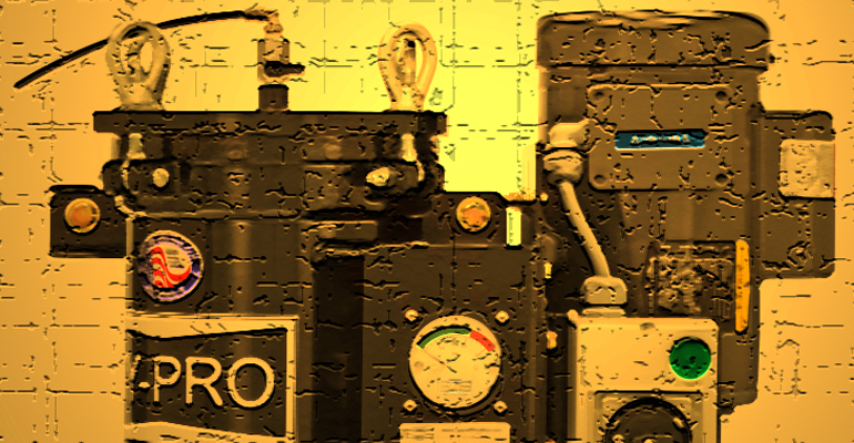

Plant personnel consulted with Hy-Pro Filtration, Anderson, Ind., for a solution. Hy-Pro representatives recommended its FSW off-line filtration system. This off-line circuit—often referred to as a kidney loop—connects to a hydraulic system’s reservoir, pumps the dirty fluid through high-efficiency filters, and returns the clean fluid to the reservoir. Representatives also recommended increasing the size of hydraulic pumps and motors to keep components operating within specifications, normalize fluid temperature, and reduce the system’s susceptibility to varnish buildup.
Results of these actions revealed that ISO 4408 cleanliness dropped to 18/15/10—a 93.5% reduction of particles 4 µm and larger. In addition, the ASTM MPC∆E value fell from 33.1 to 5.2— an 84% reduction. The number of defective units has also decreased substantially, so did downtime, maintenance costs, and the need for frequent oil changes.
All combined, these cost reductions add up to a total annual savings of $211,698 for the OEM. Based on a continuous flow rate of 0.2 gpm, the FSW system has reduced annual particulate contamination circulating in the fluid from 16 lb. to only 1 lb.
