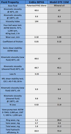

It also is possible for a polymer to undergo molecular degradation, which results in permanent viscosity loss. An FISST (Fuel Injection Shear Stability Test) was conducted on EnBio MP46 according to American Society for Testing Materials (ASTM) standard D 3945. No viscosity loss was observed. These results showed that EnBio MP46 is essentially Newtonian and shear-stable.
To evaluate the lubrication properties of EnBio Mp46, it was compared with a hydraulic fluid formulated from phosphate esters, which exhibit excellent lubrication properties. One method of quantifying the relative lubricating properties of a fluid is to determine the coefficient of friction in a Ball-on-Disc test. The test results show that the coefficient of friction associated with EnBio MP46 was substantially lower than that of the phosphate ester fluid evaluated.
The following tests were performed to document EnBio MP46’s performance in pump applications. These tests showed EnBio MP46 to result in lower wear rates than standard mineral AW oil, as well as exhibiting greater wear resistance at high pressures under various use conditions.
ASTMD 2882—This is perhaps the most common standardized test to evaluate the relative performance rankings of a hydraulic fluid. Test results comparing two hydraulic fluids showed that a typical mineral anti-wear oil exhibited a wear rate of  0.223 mg/hr, whereas EnBio MP46 showed a value of 0.018 mg/hr.
Sundstrand Series 22 axial-piston pump—The total test duration was 225 hr., and the results showed no significant flow degradation (0.7%) over the full load period.
Sundstrand Series 20 cycled pressure piston pump—This pump was tested with EnBio MP46 at various pressures ranging from 2,500 to 4,500 psi over a period of 500 hr. After the test, visual inspection of the dismantled pump showed the valve plate to be in excellent condition, with no deposits in the grooves. The housing and components showed no evidence of cavitation, and the pistons showed no signs of wear and rotated freely on their slippers.
Enerpac HUSHH Pump—This test shows whether an oil will sludge, which can create wear. The pump’s first stage is a geroter pump operating at 500 to 600 psi. The second stage is an axial-piston pump operating at 7,000 psi. After testing with EnBio MP46, inspection of the pump showed no sludging or wear problems.
The most favorable tribological properties of a hydraulic fluid—i.e. its ability to lubricate—also can affect efficiency. The following table compares EnBio to Mobil DTE 15M and highlights the large increase in efficiency EnBio provides over the highest quality mineral oil products.

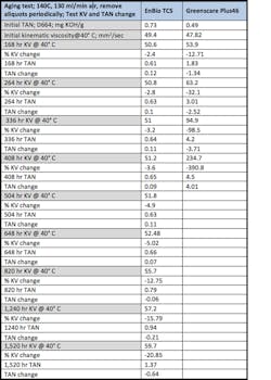

Although external factors such as contamination, cavitation, and heat caused by friction or internal leakage of a pump or motor can shorten a fluid’s life, EnBio has lasted twice as long as other fluids during actual tests on equipment. This is primarily because of its non-shearing qualities and greater oxidation stability. The following table demonstrates the longer life of EnBio fluids and their ability to resist oxidation.
