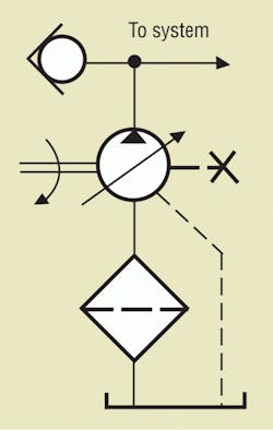

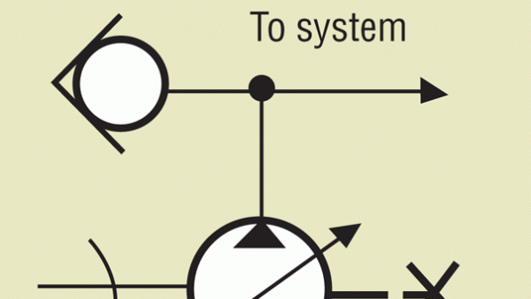

In our plant, a pressure-compensated pump from a reputable manufacturer ran hot from the day it was first started—eventually raising the reservoir temperature and tripping a safety switch. The machine involved also seemed sluggish.
Someone decided to rebuild the pump, but bearings, rings, vanes, plates, and such all checked out OK and the pump still ran hot. The next step was to replace it and when the new pump didn’t solve the problem and the shaft seal flew, we had to go back to square on.
With only four pump connections—inlet, outlet, gauge, and drain—what could be wrong? In fact, there wasn’t even a gauge in the gauge port. It had been plugged because we used downstream gauge ports with quick-connect couplings in our plant. Let’s take a look anyhow.
And there it was. The set-up man had interchanged the case drain and the gauge port. He plugged the case drain and the pump had been pushing about 3-gpm through the gauge port to tank whenever it ran. Because this port was part of the governor, it caused the pump to be sluggish on recovery. That one little line didn’t stop the system but it sure caused some headaches.
