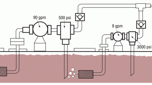

The equipment we received for a complex pressing operation included two reservoir-mounted pumps: a vane pump supplied 90 gpm at 500 psi for traverse, and a piston pump supplied 9 gpm at 3000-psi for squeeze. We quickly learned that the small pump wore out in about eight hours and later found that the larger pump had to be replaced after about six months. Pump replacement was expensive (because of frequency) and difficult (because of location); and because the line operation was critical, management ordered us to drop everything and get on the problem.
Switching from the 3000-psi pump to a 5000-psi model doubled the service life — to 16 hours — but didn’t cure the problem. Our next effort finally zeroed in on the causes — which turned out to be multiple.
We drained the reservoir, steam cleaned it, refilled it with fresh, clear fluid, left the covers off, and brought a couple of spotlights to the tank area so we could observe what happened when we next ran the system. We found that:
• a hairline crack on the inlet to the 90-gpm pump allowed air bleed into the system,
• the unload line from the 90-gpm pump discharged fluid directly at the inlet filter for the 9-gpm pump. We could actually see a stream of bubbles enter the filter to shot-peen the pump, and
• the rigid heavy outlet piping from the 9-gpm pump expanded at 2500-psi to distort and stress the pump housing, making it more susceptible to damage.
We replaced the cracked fitting, repiped both unload lines to point away from the inlet filters, and substituted a trombone expansion loop at the pump outlet to take the distortion before it stressed the pump housing.
As a result, the high-pressure pump now lasts a year or more and the low-pressure pump runs twice that before it needs to be replaced.
