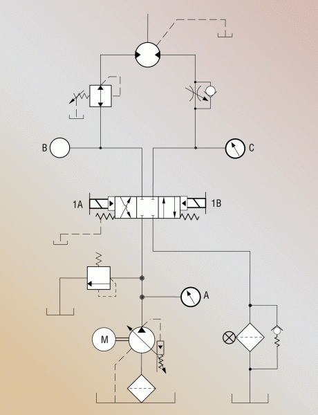

A company in Italy has a wire drawing machine that makes specialty wire for the aerospace industry. A shuttle driven by a hydraulic motor clamps the beginning of the alloy wire and pulls it through a forming die. Maintaining proper tension on the wire is important, and the pulling force from the clamping shuttle is controlled by a pressure reducing valve. Speed of drawing is controlled by a meter-out flow control.
Hydraulic schematic of wire drawing machine. Click image to enlarge.
The hydraulic motor drives a sprocket and roller chain that oscillates the clamp shuttle back and forth, pulling the wire and reversing to grab a newly cut end. The wire needs to be straight and eventually cut into 25-ft lengths. Different alloys and wire sizes require different pulling forces and draw speeds. To this end, the operator originally had to manually adjust the speed and pull forces when the machine was changed over for a different wire.
The wire manufacturer was developing a very light weight wire, which required very low pulling force, and problems occurred when the shuttle returned to the starting position. The directional valve shifted, and the shuttle started to reverse, but at a very slow speed. It didn’t make sense to the operators because there was no speed control for the return cycle.
They figured there must be something wrong with the pilot operated directional valve, so they replaced it with a new one. When the system still reversed in a creep mode, they replaced the pressure reducing valve, also to no avail.
Any idea what the problem could be?
