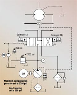

Asand core forming machine at a cast iron foundry was experiencing a problem with its mold rotation motor circuit. Personnel could rotate a mold full of sand clockwise, but when a cycle required rotating an empty mold back to the home position, ...
A sand core forming machine at a cast iron foundry was experiencing a problem with its mold rotation motor circuit. Personnel could rotate a mold full of sand clockwise, but when a cycle required rotating an empty mold back to the home position, it would not. This was because the line pressure could reach 2700 psi for clockwise rotation but only 300 psi for counter-clockwise.
Unfortunately, the workers chose to replace the pump with a new one because they couldn’t get pressure to exceed 300 psi in one direction. If the pump could develop 2700 psi rotating the mold in one direction, it certainly should be able to reach the same pressure when rotating the mold in the opposite direction.
Workers then replaced a pilot-operated proportional valve with a new one. It didn’t fix the pressure problem at the motor either. When they considered replacing the hydraulic motor, the foundry supervisor decided to call in outside help.
When I arrived, personnel told me about the lack of pressure when trying to rotate the mold back to the home position and that another problem developed after replacing the proportional valve: when they rotated the mold to the fill position, it completed its cycle, but at a slower rate. Also, pressure still would not exceed 300 psi when trying to return the mold. After inspecting the system and reviewing the circuit drawing, I determined they also had an overheating problem.
The hydraulic system had several other functions that ran off of another pressure-compensated, loadsensing pump. Two of the functions used pilot-operated directional valves that featured a separate pilot pressure pump circuit set at 250 psi. This also provided pilot pressure to the circuit they were troubleshooting. The circuit for the problem motor is shown, including the pilot pressure circuit.
Any ideas as to what the problem was?
