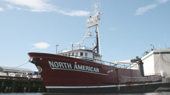

The North American cuts fuel consumption and emissions in half by incorporating fuel monitoring instrumentation and an innovative hydrostatic drive. Click image for larger view.
Commercial fishing boats burn hundreds of gallons of fuel simply travelling from home port to destination, then back again. Traditional drive systems typically have the boat’s captain choose an arbitrary speed, and because time is money, engines often operate at near their top cruising speed — usually in excess of 1000 rpm. In the case of the North American, a 35-yr old crab boat based in Seattle, running the engine 1025 rpm consumes 42 gal of fuel per hour. The North American is an 110-ft house forward fishing vessel capable of carrying a full load of king crabs weighing 170,000 lb. It ventures north from Seattle for the Alaskan king crab fishing season.
