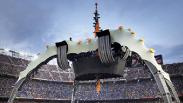

Belgian company Stageco's motto is, "If you can imagine it, we can build it." Stageco constructed three gigantic, identical stages for U2's 360° Tour. What makes this project special is that high-pressure hydraulics are being used for the first time ever to assemble and dismantle the 230-ton construction — also known as “the claw.” Together with Enerpac, Stageco has developed a unique system, based on Enerpac’s Synchronous Lift System, to raise the modular construction to a height of 30 m quickly and safely.
Being able to put on bigger and better shows than your competitors gives you a trump card in the entertainment world. Performances and tours by famous artists and bands have to look good, as is demonstrated by the glitz and special effects that are usually the main feature. The stage is crucial, and this is no different in U2’s 360° Tour. For this world tour, set designer Willy Williams and stage architect Mark Fisher came up with “the claw,” a 30-m high stage construction on four legs, giving spectators all around the stage an unobstructed view of the band.

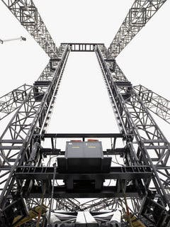

The steel stage construction consists of a central block which rests upon four legs, each made up of six sections. The central bock is gradually lifted off the ground in 38 steps and a section is added to each of the four legs after every 6 or 7 steps. A temporary truss (lifting portal) containing a supporting frame at the top has been made for each leg.
Within each truss, a hydraulic pump unit, four 350-bar high-pressure lifting cylinders (each with an applied pulling force of 20 ton and a 600-mm stroke), and four 0.5 ton, 60-bar low-pressure, locking cylinders (each with a stroke of 260 mm), are all attached to a supporting frame, which moves along the guide rails. The complete hoisting system for each stage therefore consists of 16 lifting cylinders, 16 locking cylinders and four fully hydraulic units. The lifting cylinders are fitted with a pressure transducer, a built-in stroke sensor and two proximity switches. The locking cylinders are also fitted with two proximity switches. The hydraulic pump unit includes individual pumps — one for the lifting cylinders and one for the locking cylinders. The pump units are controlled according to the master/slave principle from a central operating computer on the ground, which has a touch screen with images showing the position of the various hydraulic cylinders and their position within the lifting portals. The force of each lifting cylinder and each lifting portal is also displayed, along with the total force. What is more, a local PLC has been installed on each platform so that the lifting platform can be operated locally if necessary.
Hydraulic units move themselves up and down
First of all, the complete pump units are positioned in the lifting portals using a small mobile crane. At the beginning of the lifting process, the ends of the central block rest on the supporting frames with the Enerpac units.
When the frame is lifted, the top beams are first raised one step hydraulically, and then locked mechanically using locking pins and the hydraulic locking cylinders. The bottom locking pins are then cleared hydraulically and the cylinders raise the load to the same height. In this way, the four hydraulic units lift themselves in the lifting portals with the load, as it were, at a net speed of around 10 m/h. Lift synchronism is vital here due to the torsional stress that occurs. Stageco works with a tolerance of 5 to 10 mm. This may seem like a lot, but it is adequate since the lifting portals are 35 m apart. The operating computer’s display also shows that the load in the four portals remains in perfect balance. The display shows which steps in the lifting process have already been completed. The operator does, however, need to give the system a command for each step. After the claw has been assembled, the pump units are lifted out of the lifting portals with a crane, and the lifting portals are then removed. The system works according to the same principle but in the opposite direction when the whole construction is later lowered and dismantled. The pump units are then back on the ground and can be stored ready for transport to the next location.
