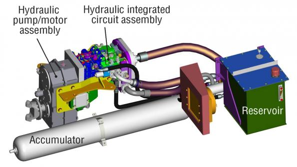

Capturing energy increases efficiency
This is most easily accomplished with a hydraulic system that uses a pump to capture the kinetic energy while the vehicle decelerates and stores it as pressurized fluid in an accumulator. That pressurized fluid is then used to power a hydraulic motor connected to the vehicle’s drivetrain when the vehicle accelerates.
Eaton has been a pioneer in Hydraulic Launch Assist technology systems for use in refuse trucks. Eaton’s Spencer, Iowa plant is the world’s largest producer of commercial parallel HLA systems for both OEM and retrofit applications on refuse trucks, shuttle busses, service trucks, and other vehicles with similar duty cycles. Refuse trucks equipped with Spencer-produced HLA systems have been driven more than 250,000 miles in daily operation, saving millions of gallons of diesel fuel.
