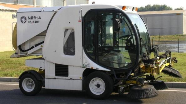

Nilfisk’s Model 1302 sweeper uses a pair of radial-piston motors to drive the front wheels of the vehicle. The radial-piston design provides the high torque needed to drive the wheels without having to use an auxiliary gear drive.

Choosing a motor to drive their RS1301 sweeper was a challenge presented to engineers at Nilfisk Advance Group, a manufacturer of sweepers, vacuums, and other cleaning equipment based in Guardamiglio, Italy. Nilfisk engineers could have chosen just about any type of motor for the sweeper, but they recognized that efficiency is becoming an increasingly important consideration among their customers, so they decided to specify a motor design that would operate efficiently and run smoothly, without cogging, even at low speed. The engineers chose to drive the front wheels of the sweeper with a pair of radial-piston motors — a design noted for its lowspeed, high-torque performance.
The RS 1301 is powered by a 67- kW diesel engine and can achieve a speed of 23 km/hr. Nilfisk engineers chose Model 250-P2G motors from SAI Spa Hydraulic Motors, Modena, Italy. The motors have a displacement of 251 cc/rev, a torque rating of 3.92 N-m/bar, peak pressure rating of 425 bar, maximum speed of 800 rpm, and maximum power rating of 59 kW. This provides more than enough muscle to scale a 24% grade.
