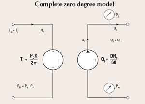

Figure 1. The left side of the zero degree model is the electric/hydraulic analog of the mechanical shaft in which the “flow” is shaft speed, and the “pressure” is a torque generator. The “I” denotes that this model is ideal, and therfore has no mechanical losses.

  1. Zero degree model has no losses and, therefore, is ideal. It is characterized completely by the two earlier equations.

Modeling of physical components must convey specific meaning to readers draulic circuits. For example, the difference between the ideal machine and a practical machine must be expressed. This is done by putting the letter I inside the pump envelope, so that the reader of the schematic is not mislead as to the intent of the symbol. This can be seen in Figure 1.
We need another extension of the symbology to encompass the more mechanical parameters, for example, torque and speed. Those ideas are implied in Figure 1. The left half is the hydraulic analogous circuit for torque and rotational speed, with a bit of my own electronic education thrown into the mix. The rotation speed flows through the mechanical circuit and through the torque generator in Figure 1, with ± polarity to indicate that the pump’s pressure-induced torque is “fighting” the input speed. Therefore, the pump is trying to reduce the input speed from a prime mover, which is not shown.
