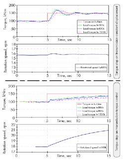

Figure 15. These measurement results, derived with an applied torque step, used two variables: constant motor displacement (upper two plots) and torque-controlled transmission (lower two plots). Click on image for larger view.
Torque step load case — Figure 15 illustrates the measurement results with an applied torque step. The two upper diagrams present the behavior of the hydrostatic transmission with constant motor displacement. The first graph plots the applied torque step and the resulting load torque measured for three different inertias of the turbine.
It can be seen that after the torque step occurs, the measured torque on the test bench also rises and oscillates to the new value. Due to the turbine’s increased inertia, the resonant frequency of the drivetrain decreases.6
The second plot from the top presents the effect on the rotational speed of the turbine. Rising pressure in the transmission increases the leakage, leading to slightly increasing turbine rotation speed. The higher the turbine’s inertia, the more energy that’s stored in the flywheel (with the slight change of speed).
The two lower plots display the same measurement, but in this case a torque-controlled transmission is employed. Here, the torque step leads to higher applied torque than braked by the transmission and, consequently, a rising rotational speed. The load torque on the test bench rises proportionally to the rotation speed until the equilibrium of torque is set again.

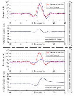

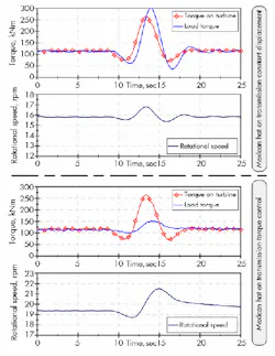

Gust-of-wind load case The measurements performed in the torque step load case also were used in the Mexican Hat load case, Figure 16. With a constant motor displacement, only a short delay occurs between applied and measured torque. The rotation speed can only rise slightly. Therefore, the peak power delivered by the wind must be transferred by the transmission. Due to the elasticity of the hydraulic drivetrain, the measured torque on the test bench is even higher than the one applied on the inertia.
Figure 16. These measurement results, derived with an applied Mexican hat, used two variables: constant motor displacement (upper two plots) and torque-controlled transmission (lower two plots). Click on image for larger view.
As with the previous load case, torque was measured on the test bench using a torque-controlled transmission (lower portion of Figure 16). Here, the turbine can speed up about 2 rpm and, thereby, store most of the peak energy of the gust. The maximum torque measured on the test bench is 120 kNm lower than the applied load. When this torque decreases, rotational speed also decreases, extracting stored energy in the flywheel and reverting to constant operation.
