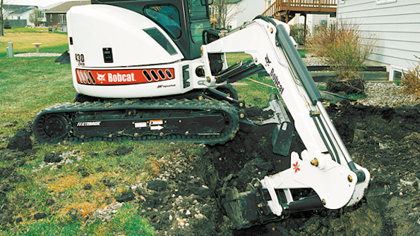

Bobcat's 430 excavator features a wide variety of hydraulic functions, including an all-hydrostatic drive system — a first for a ZHS machine.
Bobcat’s 430 excavator is a true zero house swing (ZHS) unit with the power and operating comfort of a mid-size machine. The excavator features the industry’s first all-hydrostatic drive system and improved maneuvering and traveling performance.
The Bobcat ZHS Excavators are equipped with separate piston pumps and high torque drive motors to power the left and right tracks. The FastTrack system replaces the conventional hydraulic drive system found on other excavators.
“We have taken the common zero tail swing (ZTS) excavator and significantly improved on it,” explained Tom Connor, Bobcat excavator product representative. With ZTS, the tail of the machine does not extend beyond the width of the undercarriage when slewing the machine, and the house of the machine remains inside the outside edges of the tracks throughout a 360° rotation.
“The 430 provides a greater range of house rotation when working in extremely tight applications,” offered Connor. “As long as the tracks aren’t touching a building, wall, tree or other structure, then the house won’t hit it when you’re working — whether you’re swinging from a trench to a dump truck or digging with the boom offset right or left.”
