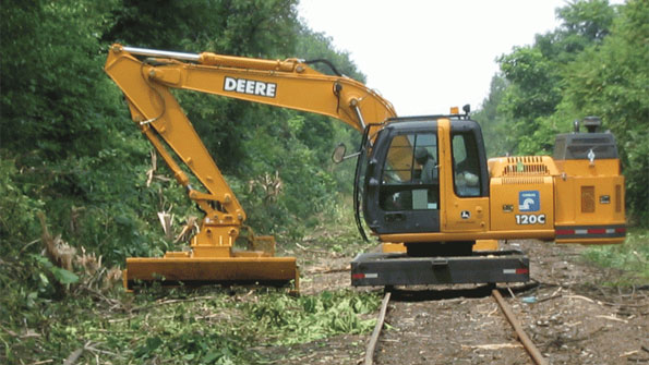

To keep vegetation safely off rail lines, Rail Construction Equipment Co. designed a unique brush cutter that uses a hydraulically-powered John Deere 120D excavator to drive the rail car chassis, eliminating chain drives and necessary maintenance. The compact hydrostatic drive is safer and more versatile than other designs.

RCE’s innovative approach to railroad vegetation management starts with self-propelled rail car chassis with a John Deere 120D excavator mounted on top. The hydraulic motors that would normally power track drives instead drive the wheels of the rail car chassis. This presents another advantage over other machines because the hydraulic wheel drive eliminates the need for chain drives and their associated maintenance.
The BC-120D’s hydrostatic drive is also more compact than chain-drive units, which allows a lower profile and higher ground clearance. Furthermore, the hydraulic motors feature integral dynamic braking and spring-applied, hydraulically released brakes for fail-safe operation. So if a hydraulic line is severed or system pressure is otherwise lost, the fail-safe brake will prevent the machine from rolling.
The machine is topped off with a 42-in. tree grinding head or 96-in. brush clearing head.
Integral hydraulic quick couplers allow switching from one cutting head to another on site.
The cutter head requires an auxiliary hydraulic power unit, which is driven by a Deere 4045T diesel engine rated 120 hp at 2200 rpm. A Deere 6066T diesel, rated 175 hp at 2200 rpm, is offered as an option. The machine also has the advantage of worldwide support from John Deere dealers.
