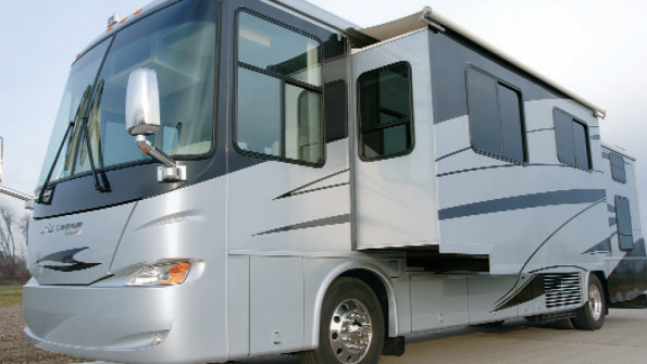

Camping means different things to different people. For some, it is sleeping on the ground — with or without a tent — and cooking over an open fire. For others, it means taking a recreational vehicle (RV) out to wide open spaces and still have all the comforts of home — air conditioning, microwave oven, washer and dryer, and even satellite TV.
Hydraulics provides an effective, compact, and economical means of extending sliding sections of recreational vehicles. In addition, a new bidirectional hydraulic power unit accomplishes the task without using a directional control valve.
Of course, not all RVs have this multitude of amenities, but for those that do, it can be difficult to fit all these creature comforts into a vehicle narrow enough to travel standard roads and still have living space. These luxury RVs have slide-out sections that nearly double the width of living space. Even if these sections could be pulled out manually, luxury demands that they extend and retract with just the flip of a switch.
Smaller RVs — about 6500 lb or less — with slide-out sections use electromechanical assemblies for extension and retraction. Larger, heavier vehicles, require the power of hydraulics because electro-mechanical systems would be larger, heavier, and more costly than a hydraulic system. Furthermore, the hydraulic system's power unit can be used not only for the slide-out section, but for powering cylinders of a leveling system as well. So instead of requiring an electric motor for every electromechanical function, the hydraulic solution can use a single electric motor and pump for all functions by using valves to route hydraulic power to the appropriate actuators.

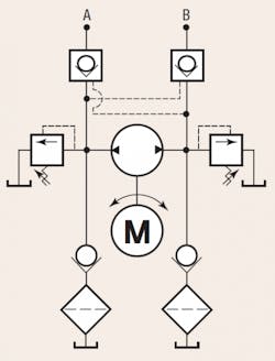

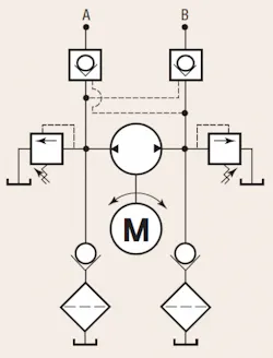

Mark Tichgelaar, of SPX Fluid Power, says the SPX Smiths Model SMR, as with most compact dc HPUs, provides the hydraulic flow and pressure for the application. But what sets the model SMR apart is that it relies on a bidirectional motor-pump instead of a unidirectional pump and directional control valve to extend and retract cylinders.
Model SMR power unit uses bi-directional motor-pump to eliminate the need for a directional control valve. Schematic shows simple circuitry, including integral pilot-operated check valves to hold loads in case of power failure.
The bidirectional motor-pump not only simplifies the hydraulic circuitry, but eliminates the expense and related costs of having a directional control valve. An added bonus is that even though the SMR operates from a vehicle's 12-V dc power, it doesn't have to have electricity to operate. It's motor has a double-ended shaft, so a user can connect a cordless drill to the shaft extension to drive the hydraulic pump. This is a more convenient and cost-effective solution than using a hand-powered pump for backup operation.
Normally, a compact dc power unit requires electric power for the motor, and an electrical signal for a directional control valve. However, the SMR has a bidirectional motor-pump, so reversing polarity of electrical power to the motor reverses flow direction from the pump.
The SMR delivers flow to 1.0 gpm at 1500 psi and accommodates working pressure 2500 psi. Its motor requires 12 V dc at up to 180 A.
