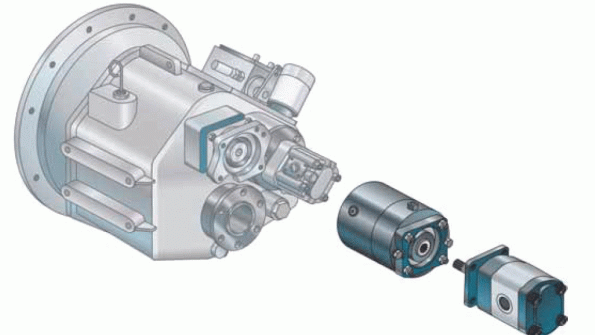

Mounting a clutch between a prime mover and hydraulic pump saves energy by transmitting power to the pump only when needed.

For example, PTO clutches have standard SAE J744 or SAE J620A flanges for mounting the clutch between a machine’s PTO, bell housing, or pump drive box and hydraulic pump. The clutch allows engaging the hydraulic pump only when needed. The clutch normally consumes no power — only a small volume of air or oil for engagement. More importantly, with the clutch disengaged, the hydraulic pump consumes no power because it doesn’t even rotate. This can yield substantial energy savings, even with variable displacement pumps. That’s because even when rotating a zero displacement, a variable-displacement pump still produces torque drag on the power train. The Logan PTO clutch can also be used to disengage a pump to keep it from overspeeding when the vehicle runs at highway speed.
