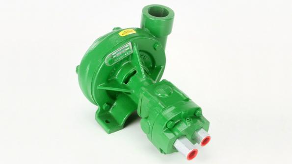

The second tandem-mounted pump is used for getting the particular liquid chemical to be applied from a 55-gal tank to the applicator nozzles on the booms. This is accomplished by a centrifugal pump driven by a hydraulic motor that delivers fertilizer, herbicide, pesticide, or other required solution to the spray nozzles. The modular motorpump package is provided by Ace Pump Corp., Memphis. Ace’s pumps can be driven by hydraulic motor, electric motor, gasoline engine, a vehicle’s belt drive or PTO, or even compressed air when the application calls for a diaphragm pump.
A hydraulic motor coupled to a centrifugal pump dispenses liquid chemicals to crops.
As can be seen in the photo, the hydraulic motor is smaller than the centrifugal pump it drives. Not so with the electric motor or gasoline engine, each of which is two or three times the size of the pump or more — thus adding considerable size and weight to the package.

Ace Pump recently partnered with Case IH to supply spray pumps for Patriot 3330 self-propelled sprayers. The spray pump is the heart of any modern sprayer, so long, trouble-free operation is imperative for today’s farmers and custom applicators. Until recently, Case IH used a constant-flow hydraulic system, so the centrifugal pump always ran at full speed.
On the newer system, however, centrifugal pump speed is regulated by routing any unneeded flow from the system’s hydraulic motor back to the system’s hydraulic reservoir. Granted, in this setup any unused power from the hydraulic pump is wasted. However, driving the centrifugal pump at variable speed still saves considerable energy.
Ace does offer even more energyefficient alternatives, but primarily provides a pumping system that best suits the specifications of the hydraulic design. For example, a variabledisplacement pump could have been used in this application to transmit only enough hydraulic power to meet demand of the centrifugal pump.
The Patriot 3330 regulates oil flow to the hydraulic motor based on demands of the sprayer. The variable speed feature of the drive improves component life by reducing the duty cycle of the centrifugal pump during low flow demand. The overall efficiency also increases because the pump only supplies the needed flow without excess bypass from the centrifugal pump.
Hydraulic motor reliability was improved by implementing the following changes:
• A case drain was incorporated to reduce pressure in its seal area.
• A perforated spacer was added between the motor bearing and high pressure shaft seal to improve oil flow.
• Internal motor venting was modified to promote oil flow in the seal area for enhanced cooling and lubrication.
The combination of the variableflow hydraulic system and motor improvements has reduced warranty claims and improved the reliability of the most critical sprayer component.
