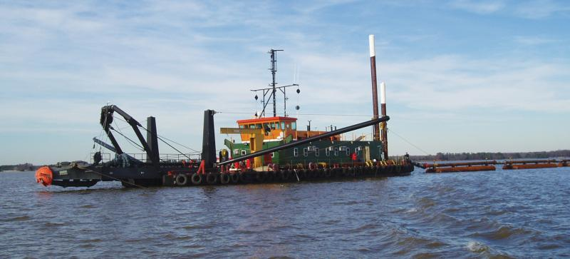

Cottrell Contracting’s dredge Lexington is 200-ft long, 38-ft wide, displaces 900 tons, and packs a total of 4250 hp. It is shown here with spuds extended and piping system behind.

Lexington’s suction cutter uses a hydraulic motor for high-torque rotation, and debris is drawn into piping for transport up to 8 mi away.
