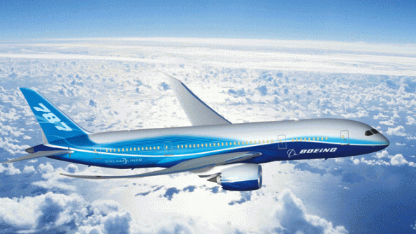

Boeing’s new 787 Dreamliner (top), scheduled for initial flight testing next year, will make extensive use of EHAs (below), which are essentially self-contained hydraulic systems.
