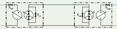

Figure 1. The practical Type 2 hydrostatic transmission can be reduced to the simple Type 1 configuration, above, by using judicious approximations.
Describing a model such as this mathematically requires four node equations to accommodate four different nodal pressures. Also required are two torque loop equations — one for the pump shaft circuit and one for the motor shaft circuit.
This creates a sixth order system dynamically and six unknowns in steady state. Rather than address all the cumbersome details associated with such a model, we shall instead consider the simple transmission represented in Figure 1 — a Type 1 model with only four loss coefficients in the transmission.
We can justify this simplification by considering the following:
• Performance of the hydrostatic transmission is affected by the transmission differential pressure, not the gauge pressures.
• If the supercharge pressure is relatively low, then the amount of flow through the port-to-case drain leakage path is small and can be ignored. This remaining leakage resistance can be combined in parallel with the port-to-port resistance.
• Because the transmission differential pressure is the dominant operational variable, all gauge pressures can be ignored. Performance, then, can be expressed in terms of differential pressure.
• The equivalent single internal leakage resistance has to be found using the combined parallel effects of the port-to-port resistance and one of the two port-to-case drain resistances. The combined results are called RLP and RLM in Figure 1.
• The study at hand will be limited to one direction of rotation and will not deal with over-running loads, thereby further justifying the above assumptions and approximations. The concepts and conclusions reached here can be extended to bidirectional and over-running operation. However, they are beyond the scope of the present study.
• The study covered in this article will be limited to steady-state performance characteristics only. All the dynamic factors — capacitances and inertias — can be eliminated.
After the simplifications are made, the hydrostatic transmission of Figure 1 can be totally described with three equations — two torque loop equations and one flow node equation.

Figure 2. Type 1 model of the hydrostatic transmission with a variable, pressure compensated pump and fixed displacement motor.
