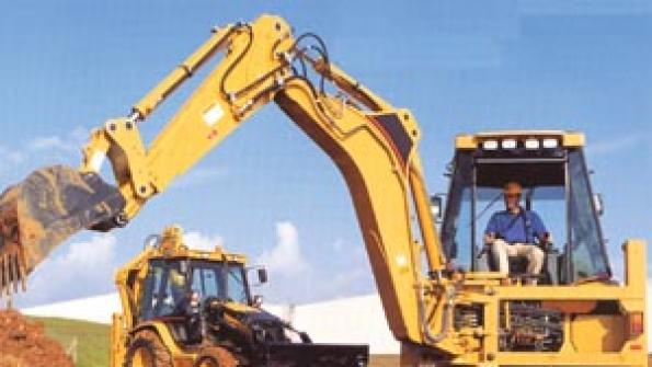

The backhoe loader continues to be one of the most versatile machines at construction sites around the globe. This versatility is due, in large part, to hydraulics.
Take a tractor for a base, attach an excavator at one end, a loader at the other, and you have a backhoe loader. That sounds simple enough, but building all this functionality into a single machine requires clever system design and strategic use of hydraulic components.
As backhoe loaders have advanced, so too have the demands placed on them. Today, attention must be paid more than ever to efficiency and controllability - not to mention ergonomics and lower exhaust and noise emissions. Hydraulics encompasses all of these.
