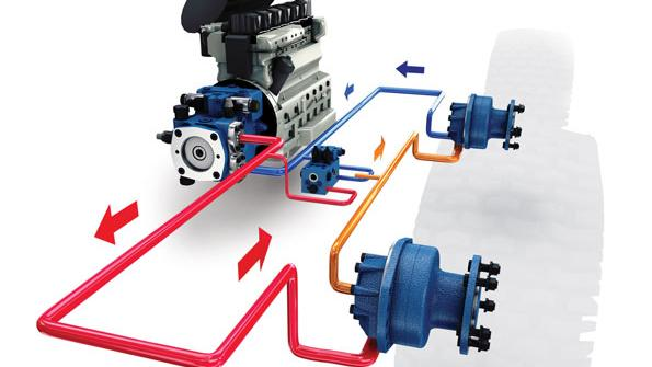

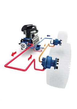

Myriad mobile machine functions exploit hydraulics technology, ranging from transit drives and swing functions to boom operation and conveyor drives. All these functions rely on a pump located somewhere in the machine to provide the power needed to accomplish the intended work. The pump’s placement within the system depends on the availability of a mechanical rotational power source to drive the pump’s input shaft (Figure 1).
Figure 1. A pump provides the power to accomplish the intended work in a variety of hydraulics-driven mobile machine functions. The pump’s location depends on the availability of a mechanical rotational power source to drive the pump’s input shaft.
Two separate base-type applications, on and off-highway, offer opportunities and distinct ways for pump-mounting locations and drive inputs. Many options are available, but keep in mind that one input isn’t preferred over another. Usually, the design envelope within which the drive designer must physically fit the pump eliminates some options — maybe even all but one. This makes it important to understand the pros and cons of each input type.

Many pump manufacturers, such as Bosch Rexroth, offer compact pump-mounting flange options or bent-axis pumps (Figure 2) that provide more clearance around the axle. Bent-axis pumps contain pistons mounted at an angle to a driveshaft, which rotates the pistons. This angle, typically around 25°, produces a compact mounting area that maintains a wide range of displacement.
Figure 2. Work trucks and other on-highway vehicles usually have the hydraulic pump mounted on the side of the vehicle’s transmission-integrated PTO, which leaves little space around the axle. The shape of bent-axis pumps lets them fit into tighter spaces than other pump designs.
