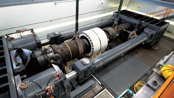

Because no such test frame existed for the size and magnitude of the loads required for this type of testing, one had to be constructed. In the new frame that Dril-Quip designed, a pair of hydraulic cylinders plumbed in parallel is mounted horizontally to a fixed beam at one end and connected to an articulating beam through two connecting rods at the other end of the fixture (Fig. 1). The test specimen is also affixed between the two beams.
Figure 1. In the Dril-Quip wellhead casing test fixture, the cylinders are mounted horizontally, one on each side of the stack under test.
To apply different bending and load combinations, the system operates the cylinders to exert a different amount of force on each end of the articulating beam. To supply adequate force, the cylinders have a bore of roughly 4 ft and stroke of 6 ft. Each double-acting cylinder can generate 6.5 million lb of force. The frame can also apply a bending moment of more than 20 million lb-ft. It has a unique ability to exert large tensile or compressive forces simultaneously with a large bending moment.
