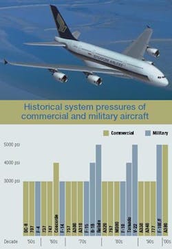

Few other industries focus on weight as much as aircraft manufacturers, and with good reason. Every extra pound contributes to fuel costs - and impacts the bottom line for the airlines. Since the 1970s, military aircraft have been using 5000 psi hydraulic systems, which use lighter-weight components to actuate the flight control surfaces. Passenger aircraft have been relegated to 3000-psi hydraulic systems (with the exception of the Concorde, which features a 4000 psi system). Now Airbus' new A380, a monster of a plane, is changing all that.

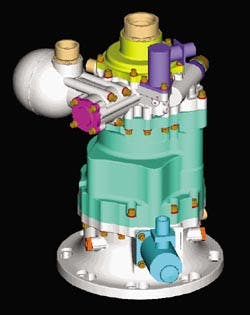

Airbus selected Eaton to provide the 5000-psi hydraulic power generation for the A380. The system consists of eight Vickers PV3-300-31 engine-driven hydraulic pumps, along with four AC motorpumps and the associated electronic control and protection systems. The pumps are pressure-compensated, variable displacement type, and deliver 42 gpm at 3775 rpm. Their displacement is 47 ml/rev.
Two unique aspects set this pump apart. First is the disengagement clutch, a feature not currently found on any commercial or military aircraft pump. In cases where a pump is malfunctioning while the plane is on the ground, the clutch can segregate that pump from the system. This allows the plane to be dispatched using the remaining seven pumps (seven pumps are needed for normal flight operations; the remaining pump is redundant, for safety). Typically, in the event of a grounded aircraft, the airlines would have to accommodate more than 500 passengers - which could be very costly to the airline. In flight, the pump can be detached in case of failure, so it won't contaminate the rest of the system. Explains Phil Galloway, engineering manager for Eaton, "The pump can't re-engage except on the ground, via manual means."
The other important feature of the PV3-300-31 is its extremely low noise and pressure pulsation. Pressure in a given 5000-psi system might vary from 4900 to 5100 psi, due to normal pressure pulsations created from the pump. On aircraft, the variation has typically been 10% or less, improving to 5% with more recent models. In order to improve reliability and minimize fatigue throughout the aircraft's fluid distribution lines, Airbus asked for a pump with ±1% pulsation.
Eaton responded with a pump model that features a built-in attenuator and an 11-piston rotating group - meeting the Airbus goal and resulting in one of the lowest noise pumps in the market.
