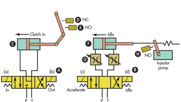

Our solution was to design a simple hydraulic system to automatically disengage a clutch and idle the onshore engine whenever necessary. To avoid installing a hydraulic power unit for this low-duty-cycle system, we chose to use the diesel engine’s lubrication system to operate the control. Of course, we were careful not to do anything to compromize the engine’s lube system, and we determined that the low quantity and infrequent need for pressurized oil posed no threat.
Using 40 psi as our design pressure, we selected a 3½-in. bore, agricultural-type hydraulic cylinder to engage and disengage the clutch and a 1¼-in. bore cylinder to control engine speed. (The smaller bore actually was a pneumatic cylinder, but the size was right and we anticipated no problems using oil at 40 psi.) We tapped into the diesel engine on the clean side of the engine oil filter and brought our return line through the timing gear cover. Hose clamps were adequate for our connections in this low-pressure circuit.
Automatic control initially relied on a switch-gauge with low- and high-pressure contacts and a trio of limit switches. The switch/gauge sensed sludge-line pressure at the booster pump inlet, and its contacts directed 12-V ac to three control relays that operate valves A and B shown in the accompanying schematic.
Referring to the schematic, when inlet pressure reaches 5 to 7 psi, the switch/gauge’s high-pressure contacts close to energize solenoid (a). Valve A shifts, and cylinder C engages the clutch. Movement of the overcenter clutch linkage releases limit switches D and E. Switch D de-energizes solenoid (a) and valve A spring centers. Switch E energizes solenoid (c) and valve B shifts to extend speed-control cylinder F, accelerating the diesel engine. (Needle valves G were used for tuning the rate of engine-speed change.)
Acceleration continues as long as the high-pressure contacts on the switch/gage remain closed. When sludge line pressure drops enough to open those contacts, solenoid (C) is de-energized. Valve B spring-centers and its blocked center holds the position of cylinder F to maintain engine speed.
When the floating dredge is shut down, sludge line pressure drops further, and the low-pressure contacts on the switch/gauge close. This energizes solenoid (d) to shift valve B to idle the engine. When cylinder F retracts, the engine’s injector pump actuates limit switch H, which energizes solenoid (b). Valve A shifts, cylinder C extends, and the clutch is disengaged.
