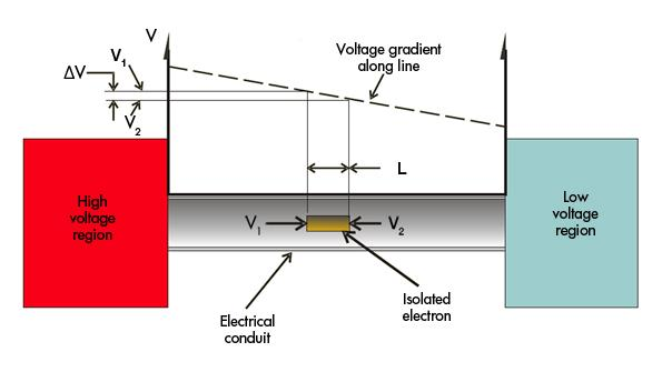

A perfectly analogous situation exists in the electrical circuit. Consider the situation depicted in simplified fashion in Figure 2. But first, consider the unit of voltage.
Figure 2. Just as the isolated fluid molecule undergoes a force motivating it to move from a high pressure to low, the isolated electron is motivated to move from a region of high voltage to low. Click on image for larger view.
Voltage is a measure of the potential energy (newton-meter, also called the joule) stored per coulomb of electrical charge. A coulomb of electrical charge is merely 6.241 × 1018 electrons. The voltage gradient that exists along the conductor has a slope of volts per meter. That gradient is called an electric field, usually symbolized as E. When the voltage is multiplied by the value of E, the result has units of newton per coulomb. The isolated electron, with its miniscule electrical charge of 1.602 × 10-19 coulomb, undergoes an equally miniscule, non-zero force. This force motivates the electron to head for the lower voltage region.
When you walk across the carpet on a dry day and reach for the door knob, your body is the high-voltage region, often thousands of volts. However, the door knob is low voltage, and the electric field is so strong that it ionizes the air, turning it into the conductor, and the result is a small bolt of lighting. On a more humid day, two conditions prevent this from happening. First, there is simply less charge transferred to your body, and second, the humidity allows any charges on your body to “leak back” to the carpet through your skin and clothing.
