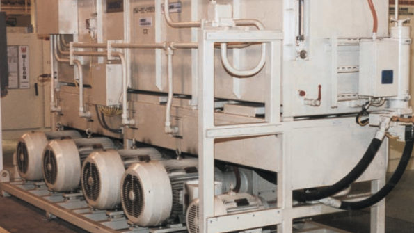

Whether a hydraulic power unit uses one electric motor or several, optimal sizing of the motor goes a long way toward saving energy without sacrificing performance.

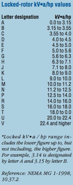

The letter designations for locked- rotor kV•a / hp as measured at full voltage and rated frequency are shown in the table. To calculate the range of inrush current (locked rotor amps) for a motor, determine its NEMA code letter from the name- plate and solve the following equa- tion for the corresponding kV•a/hp values shown in the table:
CLR= CL x hp x 1000/(1.732 x V)
where CLR is locked-rotor current,
CL is kV•a/hp from the table,
hp is the motor horsepower, and
V is the voltage.
For a 40-hp motor with letter G designation (5.6 - 6.3 kVA/hp), the locked-rotor current will be 281 to 316 a:
CLR= 5.6 x 40 x 1000/(1.732 x 460)
= 281 a
CLR= 6.3 x 40 x 1000/(1.732 x 460)
=316 a
Based on the previous example, substituting a 25-hp replacement motor (code letter F) for the over- sized 40-hp model not only decreases full-load current from 37 to 30 a, but also drops starting current from 299 to 188 a. These factors help reduce wear and tear on motor starters, contacts, and other parts from unnecessarily high in- rush currents. The substitution also improves power factor appreciably.
