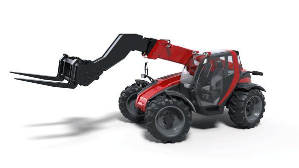

A diesel-powered telehandler was used for testing an electrohydraulic start-stop system that not only reduces fuel consumption, but cuts emissions and noise as well.

We used a telehandler for fuel-consumption testing. Two key factors were in play. First, power consumption rose whenever the accumulator was being charged. When using the control system, the increased consumption can be linked to, say, a lifting operation with an increase in engine speed. Second, the diesel engine’s consumption when idling must be considered to calculate the overall efficiency. We examined the relationship between these two factors and determined that after just 2.5 sec, the consumption advantage gained by switching off the diesel engine exceeds the energy required to restart it. The system should reduce fuel consumption by about 450 liters per year for the forklift in a typical scenario. This figure is based on a 50 kW diesel engine operating 1,000 hr/yr, idling 30% of the time, and consuming 1.5 l of fuel per hr while idling. Of course, overall fuel consumption depends on the type of machine, individual usage, and duration of work stoppages.
