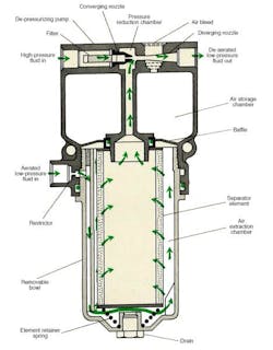

High-pressure hydraulic fluid passing through the air-oil separator removes air from low-pressure fluid bypassed from the return line.
Unfortunately, bubbles get smaller with increasing pressure. The lowest pressure in the F-104 is about 30 psig. This pressure was far too high because even at this pressure the free air bubbles would be compressed and driven through the filter screen. Total bubble removal was not possible. The next logical step was to introduce an aspirator, which would reduce the pressure in the chamber so the bubbles would expand and not penetrate the filter screen.
It was at this stage that the scheme to use a jet pump (aspirator) to lower the pressure in the separating chamber was tried. By lowering the pressure acting on the fluid, large quantities of dissolved and free air were released and the filter screen barrier was able to separate the bubbles from the fluid.

Lockheed air-oil separator. Hydraulic fluid at system (high) pressure passing through the separator creates a low-pressure region in the separator. This low pressure allows air bubbles to form in the aerated fluid and also aspirates the fluid. The bubbles are screened out by the separator (10-micron, wire mesh filter) element, and the air is temporarily stored in the air storage chamber. This air-oil separator· with a separator or filter element has been qualified for the F-104. However, other versions of the air-oil separator have the aspirator at the bottom of the unit instead of the top, avoiding the need for a filter element.
During the development testing it was noted that fluid released of its air by the separator would quickly reabsorb air when left in an exposed container. The de-aerated fluid acted somewhat like a sponge. This phenomenon was proved very beneficial in bleeding complex systems such as that of the F-104. The most remote reaches of the system are bled effectively by circulating treated (de-aerated) fluid throughout the system, reabsorbing pockets of air. Nooks and crannies that would normally never get bled using conventional bleeding methods are easily cleared of air.
On F-104 aircraft, two separators — one for each hydraulic system — are in operation whenever the aircraft hydraulic system is used, either in flight or on ground test stand power. Extracted air is easily bled-off during ground servicing with a conveniently located pushbutton-operated bleed valve in each system that sequentially blocks jet pump flow and opens the air storage chamber to the atmosphere.

An air-oil separator can be designed to fit most  hydraulic system requirements by varying the volume of pressurized flow, separating chamber and filter size, and servicing frequency.
Graph shows the great solubility of air in MIL-H-5606 hydraulic fluid. At 14.7 psia, 5606 hydraulic fluid could dissolve air up to 11% of fluid volume. Click on image for larger view.
The volume of separating flow and separating chamber vacuum pressure can be balanced by adjusting the size of the inlet restrictor. The jet pump should be sized according to the amount of pressurized flow that can be spared from the system and the amount of heat that the system can tolerate. (Pressure drop across the pump nozzle adds heat to the fluid.)
