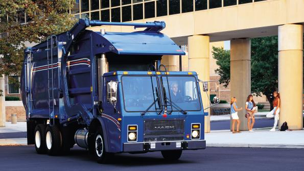

Commercial trash packer lifts a container with forks in front, then swings the container overhead and back for dumping into the rear packer compartment. Equipment such as this typically is custom built for the contractor or municipality that will operate it.
Most of us associate utilities with our monthly bills for gas, phone, electricity, and water. However, waste management is an important utility as well, and many residents now find themselves billed for garbage collection in addition to periodic sewage services. Hydraulics, of course, plays a vital role in trash collection by arming carefully engineered trucks with the power to perform multiple functions of waste collection. Front loading trucks have become commonplace to lift large, heavy dumpsters and dump their contents into the truck’s large storage bin. There, packing mechanisms compress the trash with other bulk waste so more payload can be carried. This is repeated until the bin reaches its holding capacity. Modern waste handling vehicles can service 1000 or more houses per day. The more productive the equipment is, the less the cost to individual residents.
