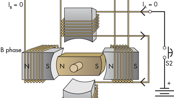

3. Opening of S2 and closing of S1 energizes the horizontal coils, and the rotor moves to the 9 o’clock position.
In Figure 3, S2 has been opened, which de-energizes the vertical coils while S1 is closed and excites the horizontal coils. With no vertical magnetic field in the presence of a horizontal field, the rotor naturally snaps into the 9 o’clock position as shown.
