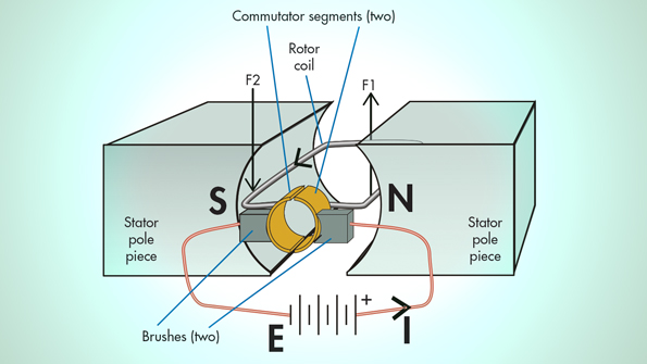

Figure 14 offers a very simplified drawing of a dc motor in its most basic form. Here, the rotor coil has only one turn. However,  making this type of motor operate requires many more turns to develop practical amounts of torque. The stator pole pieces are shown as permanent magnets, and, indeed, some small motors are built with a permanent magnet stator. In larger motors, controllable current through coils powers electromagnets. Later on, we’ll show that the stator coil current in the dc motor is perfectly analogous to the displacement adjustment in variable-displacement pumps and motors.
14. A basic dc motor consists of stator pole pieces, rotor coil, commutator, and brushes all powered by a battery or some other direct-current power source.
The dc motor of Figure 14 works as follows: The stator magnets provide a source of magnetic flux. When the rotor, through the brushes and commutator segments (collectively, the commutator segments are simply called the commutator), are connected to an external battery as shown, the right-hand side of the current-carrying rotor coil is immersed in the magnetic field. It subsequently experiences a force due the current being carried in a direction away from the viewer.
The right-hand rule leads to a force that is directed upward (recall that the direction of the stator magnetic flux is from the N pole to the S pole) on those conductors. As the current returns to the commutator on the left side of the rotor coil, it experiences the same magnetic flux, but the current direction now comes toward the viewer. The opposite direction of current, but with the same N-to-S field flux direction, causes a downward force on the left side of the rotor coil. The result is a torque that tends to turn the rotor in a counterclockwise direction.
The commutator keeps the current in the rotor coil going in the right direction in the two sides of the coil. Assume the rotor is in the position shown in Figure 14 and spinning in the counterclockwise direction. At that point, the coil experiences the greatest amount of flux from the stator magnets and therefore generates the greatest amount of torque. The breaks between the two commutator segments are situated at the 12 and 6 o’clock positions, as shown, and the current can freely enter and leave the coil through the fully contacting brushes and their respective commutator segments.
However, when the rotor turns 90 degrees counterclockwise from the position shown, three actions occur. First, the rotor coil sides move parallel to the stator flux, which doesn’t generate any voltage. Second, the brushes, which are wider than the gap that separates the commutator segments, create a short circuit across the battery and across the two ends of the rotor coil. Third, this is the point where the actual commutation takes place.
If the rotor turns, say, about 15 or 20 more degrees, the coil side that carried current away from the observer now begins to carry current toward the observer. In other words, the instantaneous current in the rotor coil is forced to change direction. The rotor is actually carrying alternating current even though it is a dc motor! This is perfectly analogous to a hydraulic motor in which the pistons, gears, or vanes, through their reciprocating actions, carry alternating flow while the port plate (hydraulic commutator) converts the incoming direct flow into internal alternating flow. The commutator in the dc motor converts the incoming direct current in internal alternating flow.
The short-circuit condition at the commutation point is clearly a problem. As the motor operates, the brushes and commutator create energy-wasting arcing. The brushes for the motor, as shown in Figure 14, are too wide for the separation gap, and would lead to excessive current. The gaps must be widened and/or the brushes have to be narrowed in order to be practical. The problems with commutation in the dc motor are almost perfectly analogous to the problems of crossover in a piston pump, when the piston diameter is greater than the separation between the kidney ports.
The flux-conductor-current condition, as stated previously, accounts for the rotor’s maximum torque in the position shown in Figure 14. It also results in the largest amount of induced counter voltage in the rotor.
