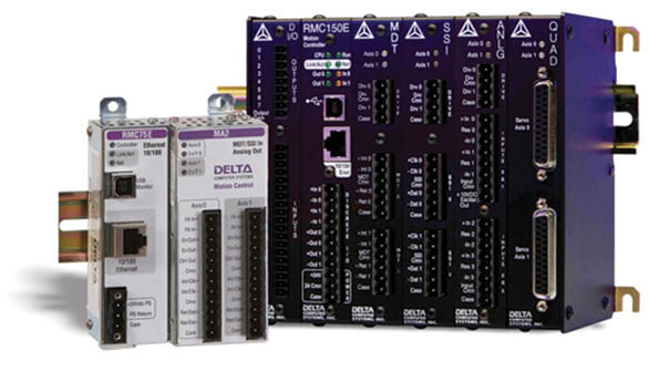

To control the hydraulics, Parker Hannifin selected the RMC150 motion controllers from Delta Computer Systems Inc. (Fig. 2, right).  The controllers handle the pre-processing of data from the load cells using a feature called custom feedback, which allows the motion-control loop to use feedback from a source other than directly from the hardware input. Instead, axes defined with custom feedback obtain feedback values to be used by the control loop from an internal register. A user program that continuously monitors all of the inputs from the sensors calculates the average feedback value and assigns it to this register.
2. The Delta RMC75 two-axis controller (left) and RMC150 multi-axis controller (right) can connect a single axis to multiple feedback sources using their custom feedback pre-processing capability.
In Parker’s press application, the user program tests and averages the data from each load cell in the group of three connected to it. The resulting average is used as feedback to precisely control the force applied to the pressure plate. Averaging the load-cell readings also reduces the effect of any electrical noise in the system, which helps the control loop produce smooth outputs to the servo valve.

This solution was adopted by Wilson Co., Systems Div., Addison, Texas, in developing a new hydrostatic test platform called IntelliTest for use by the oil and gas industry (Fig. 3). Wilson engineers needed a controller that could switch on-the-fly between pressure-feedback devices of different sensitivity ranges, and their search brought them quickly to the RMC75 motion controller (Fig. 2, left). It may at first seem strange to use a motion controller because no visible motion occurs in this application. But an electrohydraulic motion controller excels at controlling pressure, which is the focus of the hydrostatic testing process.
