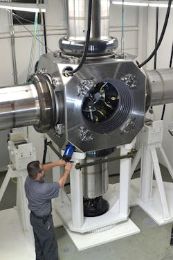

1. Novatek’s four-kiloton solid-frame press creates supermaterials, such as industrial diamonds, by using six hydraulically driven cylindrical cartridges to compress target materials under millions of pounds of pressure.
Tremendous Pressure from Six Directions at Once
Novatek built and operates ten four-kiloton, six-axis presses, creating supermaterials for applications ranging from drill bits to medical implants. Each press consists of a large, solid, cube-shaped alloy frame, 49.5 in. on each side, weighing 7.25 tons and mounted on a custom base. Six hydraulically driven cylindrical cartridges are positioned around all sides of the cube frame; each cartridge is tipped by a tungsten-carbide anvil.
During operation, a specially created cubic workpiece called a cell is placed in the center of the press. This cell, measuring 17.25 in.3, contains raw materials embedded in a pyrophyllite shell. With the raw materials inside, the cell is then compressed, crushed, and transformed by all six cylinder cartridges at once.
All six cylinders, which weigh nearly 9,000 lb each, contain proprietary Novatek technology and are driven into the center of the press by hydraulic pressure. They’re synchronized to meet within a few thousandths of an inch of each other as they precisely crush the work piece in a controlled manner.
