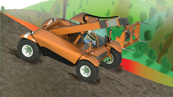

Center of gravity—A compact hydraulic motor keeps the drive’s center of gravity lower than with purely mechanical drive trains, resulting in high stability, even when operating on very steep slopes. The vehicle’s overall performance is thereby improved, and the risk of overturning reduced.

Low center of gravity and precise traction control even on steep, unstable surfaces are hallmarks of hydraulic drives for off-highway machines.
