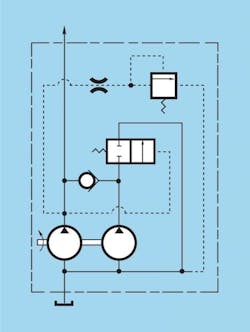

Unloading circuits
Unloaders combine the high-flow capabilities of tandem pumps with the low-power requirements of a single pump. Fluid flows from both pump sections until a predetermined pressure and/or flow is achieved, depending on the design. At that threshold, one pump section begins recirculating fluid from its outlet to its inlet, which reduces flow output of the pump to the remaining section. This, in turn, reduces the pump’s power requirement to slightly over that needed to operate the still-pressurized section. The percentage of reduced flow depends on the ratio of the displacement of the unloaded section to the displacement of both sections. Integral or bolt-on unloading valve circuits reduce or eliminate tubing, hose, fittings, and their potential for leakage.

The pressure-sensing unloader is the most common design. In this unloader, Figure 2, a spring holds the valve’s spool in its high-flow position. At a predetermined pressure, a relief valve opens to allow hydraulic pressure to shift the spool to the low-flow position. The pressure-sensing unloader most often supplies fluid to cylinders needing rapid rod extension, followed by low-speed, high-pressure operation at the end of a stroke. The pressure-sensing unloader is basically an automatic version of the manually actuated unloader that reacts to system pressure. Familiar applications include log splitters and hydraulic vises.
