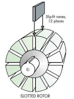

3. Inserting a vane into each rotor slot builds the rotating group of a vane pump.
The vane pump’s moving parts consist of a slotted rotor into which rectangular vanes are inserted, one vane for each of the slots (Fig. 3). Clearances between the vanes and slots are such that a compromise is made between having the vanes freely sliding within the slots and forming a fairly high impedance (low internal leakage) path between the high- and low-pressure sides. The pump design in Figure 3 has 12 vanes, but any even or odd number of vanes can be used.

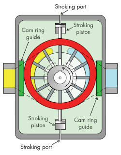

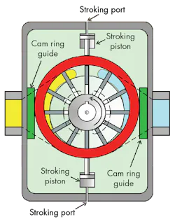

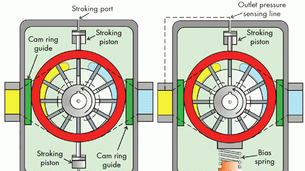

7. Stroking pistons plus external access through hydraulic ports allow the cam ring and displacement to be varied.
Now, though, the need arises for some external means of changing the cam-ring position so that pump output can be changed at will, or changed automatically using feedback. The stroking pistons shown in Figure 7 provide that capability.
External ports allow hydraulic access to the pistons, usually with an electrohydraulic servo or proportional valve. Electrohydraulic stroking is done by closing the loop on the cam-ring position with a position transducer, most often with a linear variable differential transformer (LVDT), not shown in Figure 7. Cam-ring guides (dark green) prevent its right-left movement.

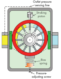

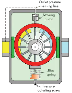

Pressure compensation in the variable-displacement pump is easily achieved via hydraulic methods. Pressure compensation equips the pump with internal feedback that automatically reduces displacement if a threshold pressure is exceeded.
In fact, pressure-compensation pumps can be safely deadheaded; that is, the output port can be totally blocked without damaging the pump. One way to achieve pressure compensation of the vane pump is shown in Figure 8.
8. Pressure compensation can be achieved by connecting the stroking piston port to the outlet pressure and replacing the lower stroking piston with an adjustable bias spring.
Here, the lower stroking piston has been replaced by a bias spring with a pre-compression adjusting screw. The upper stroking piston’s hydraulic port is connected to the outlet pressure so that the piston “senses” the outlet pressure. The bias-spring pre-compression causes an upward force on the cam ring, forcing the cam ring into the position shown when the outlet pressure is low. Under this operating condition, the pump operates like a fixed-displacement pump at max displacement and max output flow.
As the load pressure builds, the stroking piston exerts an increasing force on the top of the cam ring. At some point, the stroking piston force exceeds the pre-compression force of the spring, which automatically decreases the displacement. Blocked port pressure and deadhead pressure mean the same thing, i.e., the pressure at the outlet port under the condition of zero output flow. It is analogous to the Thevenin voltage of an electrical generator or other voltage source.
The preceding figures on vane pumps are not necessarily depicting actual construction practice of such machines. Instead, they show the principles of operation. For example, pressure-compensated vane pumps do not use physical stroking pistons. A less-costly method is to rotate the kidney ports slightly in the direction shaft of rotation, counter-clockwise. A tremendous force acts on the inside of the cam ring at high pressures, upwards of tens of thousands of pounds in large pumps at high pressures.
By rotating the kidneys ever so slightly, a component of force emerges in the down direction. That force is used to act against the bias spring and force the cam ring downward in the face of high outlet pressures. Therefore, no stroking piston is needed. And eliminating the stroking piston can significantly reduce the size of the pump body. Many other practical construction details exceed the scope of this brief look at electric and hydraulic analogies and principles of operation.
