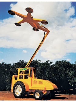

To help growers maintain trees in their orchards at the optimum width and height, TOL Inc., Tulare, Calif., developed the TH1100 combination hedger/topper. Trimming trees has never been easier or faster. The TH1100 can cut both large and small citrus and deciduous trees, with the ability to maneuver in tight orchards over a wide variety of ground conditions.

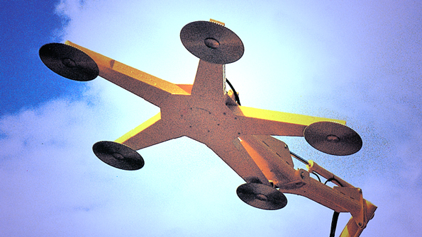

Five large-diameter saws arranged at the end of individual arms on a star wheel (the star-shaped structure containing the saws) slice off unwanted brush, and the arms themselves help transfer the material away from the tops of trees, allowing it to fall in between rows. It ultimately improves crop yield, while preventing trees from reaching heights that are beyond the reach of human pickers.
The TH-1100-L combination hedger/topper can cut both large and small citrus and deciduous trees, and can maneuver within orchards over a wide variety of ground conditions. Its hydrostatic drive provides precise control for maximum productivity, safety, and reliability.
Hydraulics plays a key role in virtually every operating function of the TH1100. It is powered by a 100-hp John Deere 4045T turbocharged engine driving an Eaton model 76 hydrostatic transmission. A gear pump provides hydraulic power for auxiliary functions: tower lift cylinder, horizontal-to-vertical positioning cylinder, cutting star swing cylinder, cutting star leveling cylinder, and engine hood lift cylinder.
