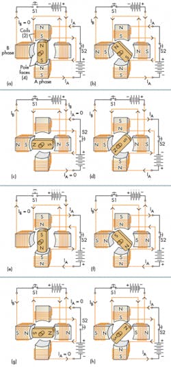

This hydraulic stepper motor is perfectly analogous to the electrical stepper motor, Fig. 19 , which  has steps that include simultaneous energizing of adjacent stator coils. The result is the ability to achieve the intermediate shaft positions between the 12, 9, 6, and 3 o’clock positions. The same can be accomplished with the hydraulic stepper motor. In fact, if the P1-to-P3 differential pressure is a cosine function while the P2-to-P4 pressure is a sine function, the motor will rotate at the frequency of the sine and cosine functions.
19. When the control system allows both phases to be energived simultaneously and individually, intermediate angular positions are possible through proper sychronization of switch operations and current direction (battery polarity).
Stepper-motor usage has a simple premise from the user’s viewpoint: We want to send a series of electronic pulses, and have each pulse result in a specific angular position change of the output shaft. For example, we may want a pulse train consisting of, say, 52 pulses to result in a precise change in the shaft angle of 52 deg. The basic idea behind a user-friendly system is given in Fig. 20. Accurate incremental division requires that the piston pressures be precisely controlled and coordinated.
In this example, the resolution of the stepper-motor system would be 1 deg. per input pulse. Then, by way of lead screw, rack and pinion, or other rotary-to-linear translator, linear position can be achieved without the need for closed-loop feedback control systems. When the controller consists of the simple on-off valve system suggested in Figs. 15 through 18, the resolution of the system is 90-deg./pulse (valve shift operation, one at a time). A more sophisticated electronic control method is required, allowing for what is referred to as microstepping.
