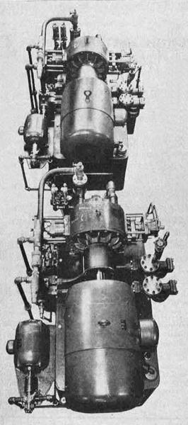

These power packages, which supply oil to the cylinders, are connected electrically so that they operate simultaneously.

Referring to the circuit drawing, the pumps are normally on negative or idle stroke so that the actual pressure port becomes a suction port and oil is pulled from the tank through the check valve, and circulates back to tank at zero pressure. Pressing the “up” button energizes solenoid A-1 in the main pilot valve, and B-1 in the control valve for the double acting pump stroking cylinder. The 2 inch, four-way two position valve, which provides directional control of the cylinders, shifts to the “up” position; the pumps are stroked from full negative to full work stroke which builds up the oil delivery slowly to accelerate the car. Releasing the button de-energizes B-1, but not A-1, and the pump is stroked back to negative or idle position, decelerating the car to a stop.

To provide pilot pressure for stroking the pumps and main valve, each unit incorporates a 3 gmp gear pump operating at 200 psi. A pressure switch in each of these pilot circuits functions as a safety device to prevent the control circuit from functioning unless pilot pressure is established. These switches tie in with the main motor starters so that the main pump motors will start only when pilot pressure has been developed.
