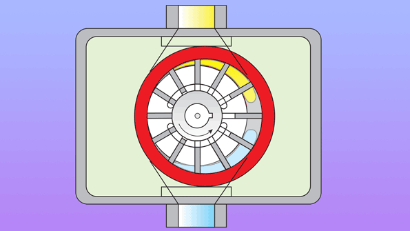

2. The rotating group and cam ring are inserted into the pump body, and again, the non-concentricity of the shaft and cam ring are apparent. The pumping chambers, i.e., the circular trapezoids bounded by the rotor, the cam ring, and consecutive vanes, absorb the inlet fluid and expel the outlet fluid.

The analytical schematic for the practical pump can be conceived by first looking at the machine construction. When the pump is tested in standard fashion—say, in compliance with ISO 4409 [21]—the output data show a measurable drop in output flow as output load pressure is increased with the input shaft regulated at a constant speed. The cause is simple: Internal leakage is directly proportional to outlet pressure. That is, the pumping elements, gears, vanes, or pistons displace a fixed amount of fluid each and every revolution, but some of that displaced fluid does not find its way out the outlet port to do useful work. Instead, it slips from the high-pressure regions within the pump and back to the inlet port. There are three identifiable and separate internal leakage paths. They can be visualized by reviewing the construction of a pump, such as the vane pump cutaway in Fig. 2.
Referring to Fig. 2, when the rotor is spinning clockwise and “dragging” its vanes along with it, the blue port is the outlet, high-pressure port, and the yellow is the inlet, low-pressure port. That means all the internal regions to the right of the two vanes (one at top dead center and the other at bottom dead center) are separating the low-pressure regions from the high pressure. Huge pressure differences will be imperfectly sealed by the vanes, which are in sliding contact with the inner surface of the cam ring, the rotor-vane slots, and the two end-plate surfaces. The sliding contact means that gaps, tiny though they may be, are present at all the sliding surfaces. The parts are riding on a thin film of fluid, usually oil, providing lubrication for the sliding parts. Some of the leakage fluid passes directly from the high-pressure zone to the inlet kidney port to be immediately recirculated to the outlet. This is referred to as port-to-port leakage and is carried through the port-to-port leakage path, RLPP, in Fig. 3.
3. Two-port characterization of the Type 2 variable displacement pump incorporates the loss elements made up of mechanical friction and internal leakages, of which there are three. There also appears a fifth hydraulic port, labeled CD for “case drain” port.
There is another identifiable leakage path. It carries fluid from the high-pressure port—mostly along the ends of the vanes and the rotor—into the low-pressure cavity inside the pump housing. Because the shaft must penetrate from the outside environment to the interior of the pump, the shaft must have a sliding seal. The seal prevents the hydraulic fluid from seeping from the pump interior to its exterior.
This means the pump housing can experience relatively high pressure, as much as 50% of the outlet pressure. Both the housing and the shaft seal must accommodate this high pressure, which raises the cost of the shaft seal and the housing. To relieve the housing (case) pressure, many pumps and motors have an external drain port, commonly referred to as the case drain. It connects from the pump housing to the fluid reservoir. The high pressure-to-case-drain leakage path is identified with the RLACD algebraic symbol, meaning the leakage goes from Port A to the case drain.
At this point symmetry takes over in the assessment of internal leakage. Figure 3 shows a third leakage path symbolized with RLBCD. An examination of the pump’s innards reveals that if a leakage path exists from the high-pressure region to the case, then a similar path must exist between the low-pressure inlet port and the case. Such a path does exist, and its effects can be measured, for instance, when both the outlet port and inlet port are at high or relatively high pressure, as can be the case in the hydrostatic transmission. The leakage resistance loss coefficients are symbolized with RL, followed by an identifier extension on the subscript. The higher the leakage resistance, the lower the internal leakage at a given pressure, and the more efficient the pump.
