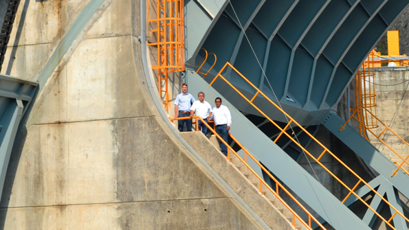

Bosch Rexroth employees (left to right) Manuel Schuhmann, Martín Gómez, and Abraham Huerta stand in front of the modernized spillway gates to provide scale for the size of the gates.

Built between 1958 and 1966, the 138-m-high dam, which is officially known as the Nezahualcóyotl Dam, holds back a lake with more than 10 million m3 of water and a surface area of about 110 km2. The dam protects the lowlands of the Federal State of Tabasco against yearly flooding and also contains six turbines, which generate hydroelectric power for the region.
The Comisión Federal de Electricidad (CFE) operates the dam and invests regularly in the safety and availability of all its technical equipment. Last year the Comisión decided to modernize three of the dam’s seven spillway gates, which regulate the water level of the reservoir. Each spillway had an electric motor driving two pinion gear drives via a drive shaft. The motor had been raising the 170-ton spillway gate using chains on each side ever since the dam went into operation in the 1960s.
Martín Gómez, project manager at Bosch Rexroth in Mexico, recalls the CFE’s invitation to tender for this project: “We initially proposed a solution with long-stroke hydraulic cylinders to drive the gates.” The team had already used this proven type of drive in new construction many times—such as the La Yesca Dam, also in Mexico. However, the concrete structure at the Malpaso Dam proved to be unsuitable.
Without reinforcement, the wall could not withstand the forces of the cylinders. And converting the concrete structure would have been a lengthy and complex process. “So we developed a solution that uses the existing chain hoist,” Gómez  explains, “but with all the advantages of hydraulics.” Schuhmann adds, “In steel construction for hydraulic engineering, the most important factor is safety. When we were able to show that similar hydraulic systems were already being successfully used in other dams, we got the contract.”
